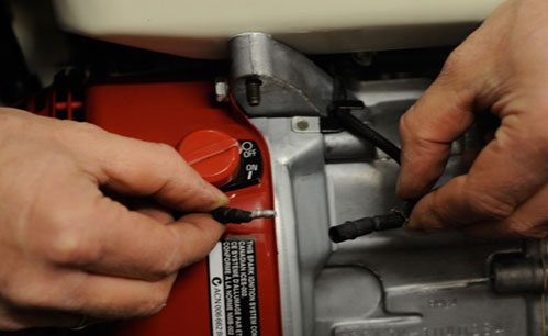

1. Remove a bolt from the tank mounting bracket.

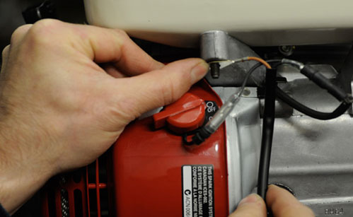

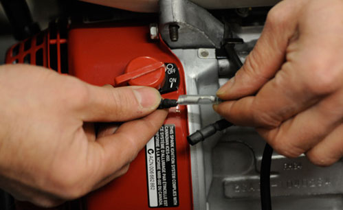

2. Disconnect the existing kill switch bullet connector (Note: on some engines including CPR engines this will be enclosed in a plastic protective bullet case. Open the case and the connector will be inside.

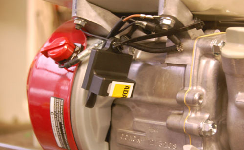

3. Fit the male bullet connector from the RLIME1 to the female connector you just disconnected in the previous step. Fit the female bullet connector from the RLIME1 to the mail connector you just disconnected in the previous step. The kill switch is now routed via the RLIME1.
4. Fit the loop end wire to the bolt or nut removed from the engine mount bracket (*Note, do not remove any existing ground connections).

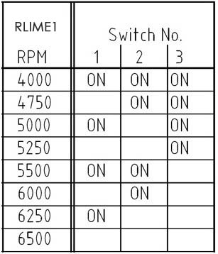

5. Set the dip switch on the RLIME1 to the desired RPM limit as per the table below.
