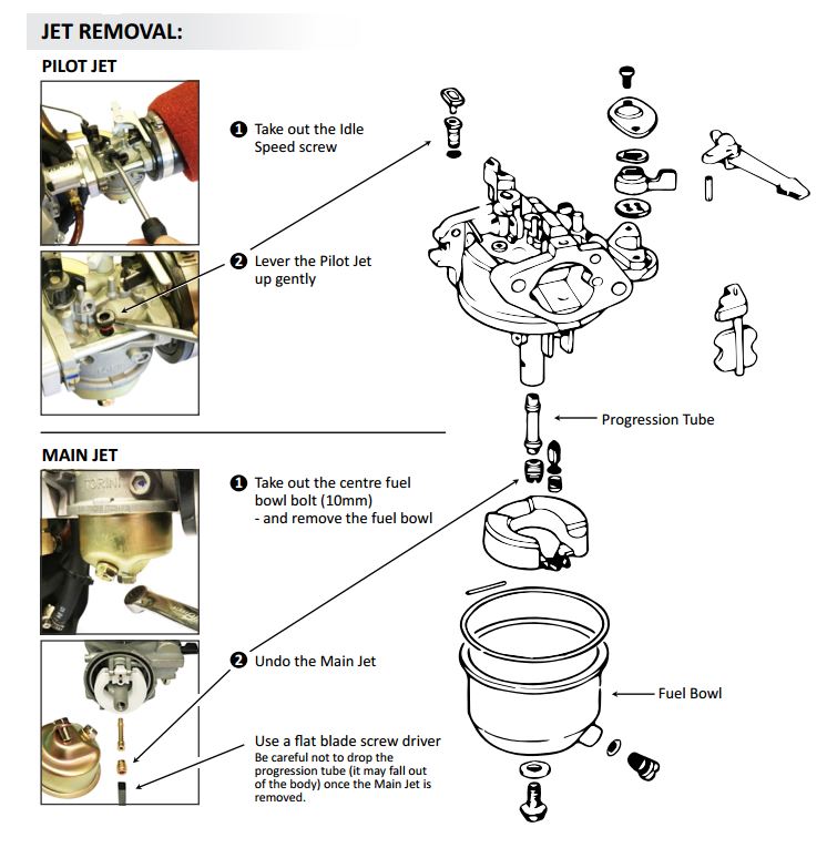

MAIN JET
The Main Jet; is the most critcal for ensuring full power operaton, correct engine temperature and thereby a
long engine life.
PILOT JET
The Pilot jet and the low-speed idle mixture screw; work together, the pilot jet controls the amount of fuel
available and the low-speed idle mixture screw allows you to precisely control the idle mixture being allowed
into the engine at idle.
To recap a bigger main jet has a bigger hole in it, which lets more fuel into the engine making it richer!
Straight forward enough, but the main jet is also absolutely CRITICAL to high-speed engine operaton in
another way. Not only does it meter the amount of fuel going into the engine, it also controls the running
temperature of the engine as well. If you run too lean the engine will overheat causing damage.
A correctly sized main jet will let the engine make good power for a long tme without overheatng. The
problem is that a main jet just 1 size too small may make greater power, but the engine life will suffer as the
operatng temperature becomes extreme. A slightly rich mixture burns cooler than a lean one, so be sure the
main jet is big enough.

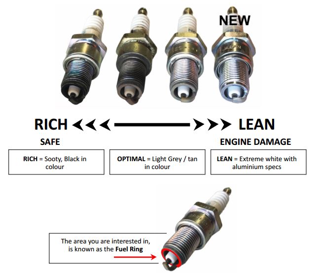

What does a spark plug look like for different mixture conditons?
To obtain an accurate plug reading, run the engine on track for at least 20 minutes, as a new plug will not colour
immediately. A spark plug can only be read correctly, if the engine is shut down immediately afer entering the
pit lane area; do not allow the engine to idle.
The area you are interested in,
is known as the
Fuel Ring
RICH
= Sooty, Black in
colour
OPTIMAL = Light Grey / tan
in colour
LEAN = Extreme white with
aluminium specs
