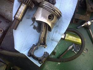

WHY DO STOCK RODS FAIL?
With your stock rod, the only thing between the aluminium rod and your steel crankshaft journal is a thin film of oil. This in itself isn't bad - oil is always required at this interface even with an aftermarket rod, it's just that at high speed the oil bleeds back out of the tiny hole in the rod, leaving the shaft and rod un-lubricated. It gets hot and seizes, causing catastrophic engine failure and taking the block, piston and head with it. Never a good look.
