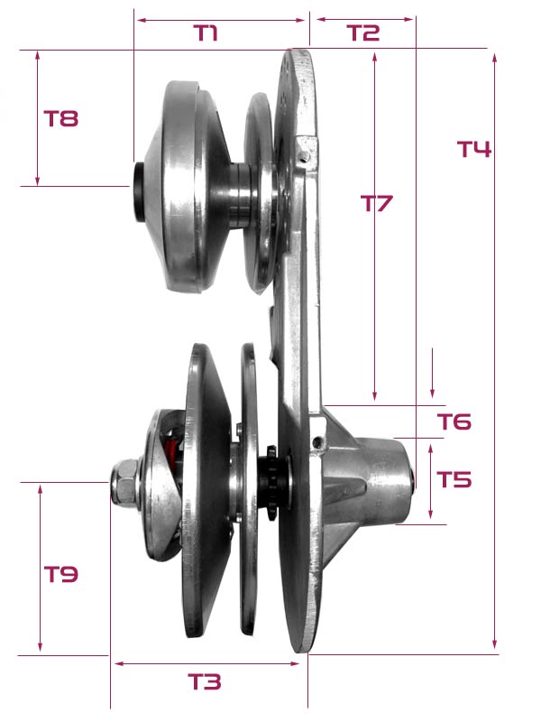

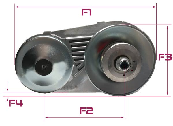

DIMENSIONS
F1 = total length of backplate including pulleys: ~330mm
F2 = pulley centre to centre distance – ~170mm
front pulley diameter - ~130mm
F3 = rear pulley diameter - ~160mm
F4 = NOTE - this is not a distance, it is a view angle issue - the rear pulley does not protrude past the bottom of the backplate.
Backplate height at highest point (lowest to highest point): ~170mm
NOTE: Add approx. 5mm top and bottom for cover clearance
width,
T1 = (Width of backplate to front of pulley front: ~80mm
T2 = Depth of Jackshaft to rear of backplate: 60mm
T3 = Width of backplate to end of pulley retaining nut on rear pulley: ~100mm
Width of backplate to front of rear pulley: ~60mm
NOTE: Add approx. 10mm to front of pulley retaining nut on rear pulley for cover clearance)
T4 = Length of backplate: ~330mm
T5 = Diameter of Jackshaft housing: 48mm
T6 = Distance between beginning of re-inforcement bracket and beginning of jackshaft housing proper: 25mm
T7 = Unobscured length of backplate connected to engine:  195mm
T8 = Distance from front edge of backplate to centre of output shaft on engine / centre of front driver pulley: ¬70mm
T9 = Distance from rear edge of backplate to centre of jackshaft / driven rear pulley: ¬90mm
