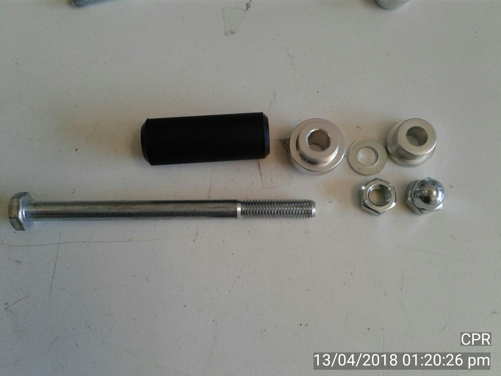

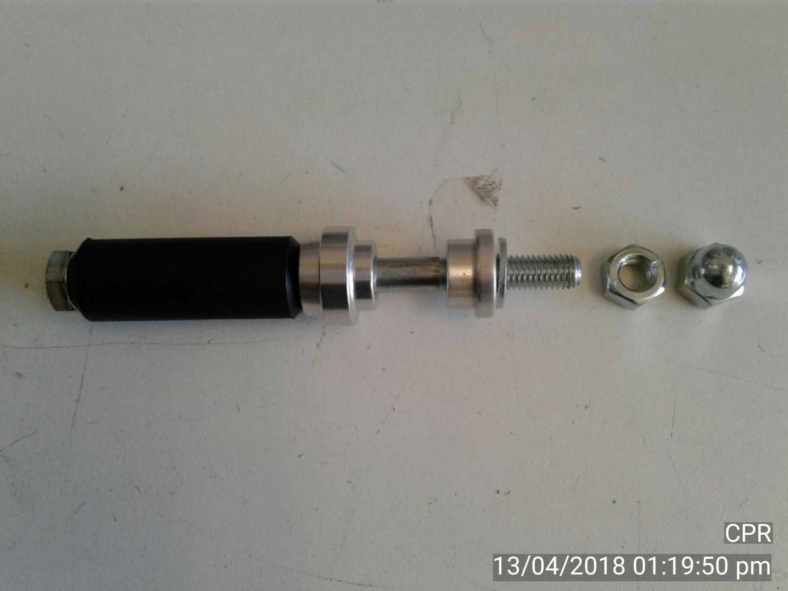

Here's a quick step-by-step guide to assemble the bolts and inserts in the kit:

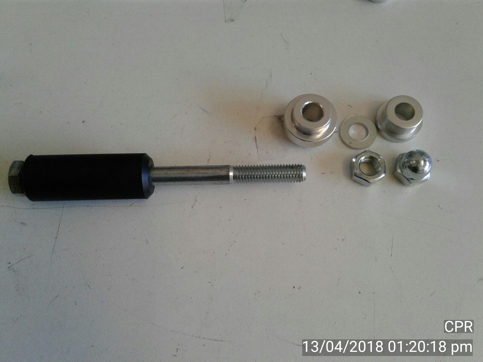

First slide the insert over the bolt.  The bolt head will be the first thing inserted into the tube or chassis rail when installing the complete insert.

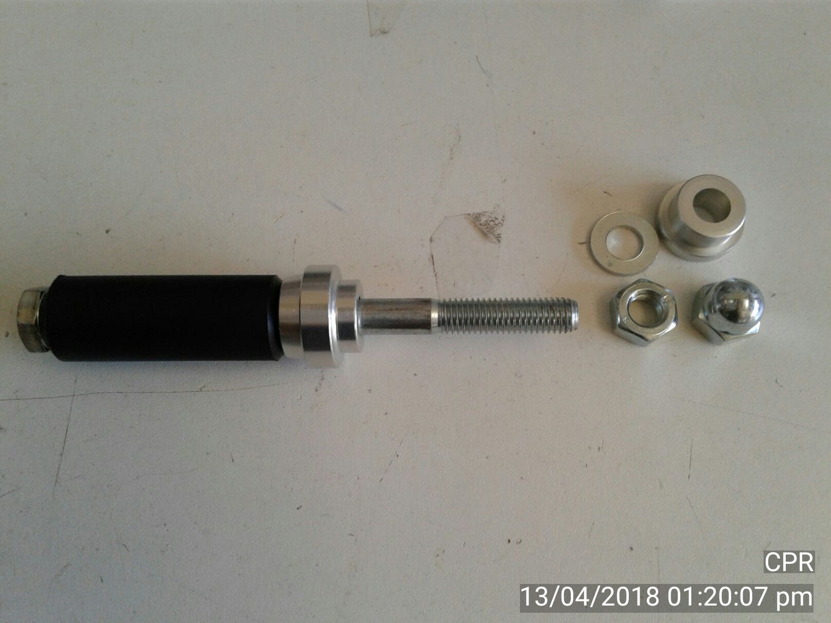

Slide the double sided aluminium bush over the bolt and down against the rubber insert, with the larger tapered flange first.

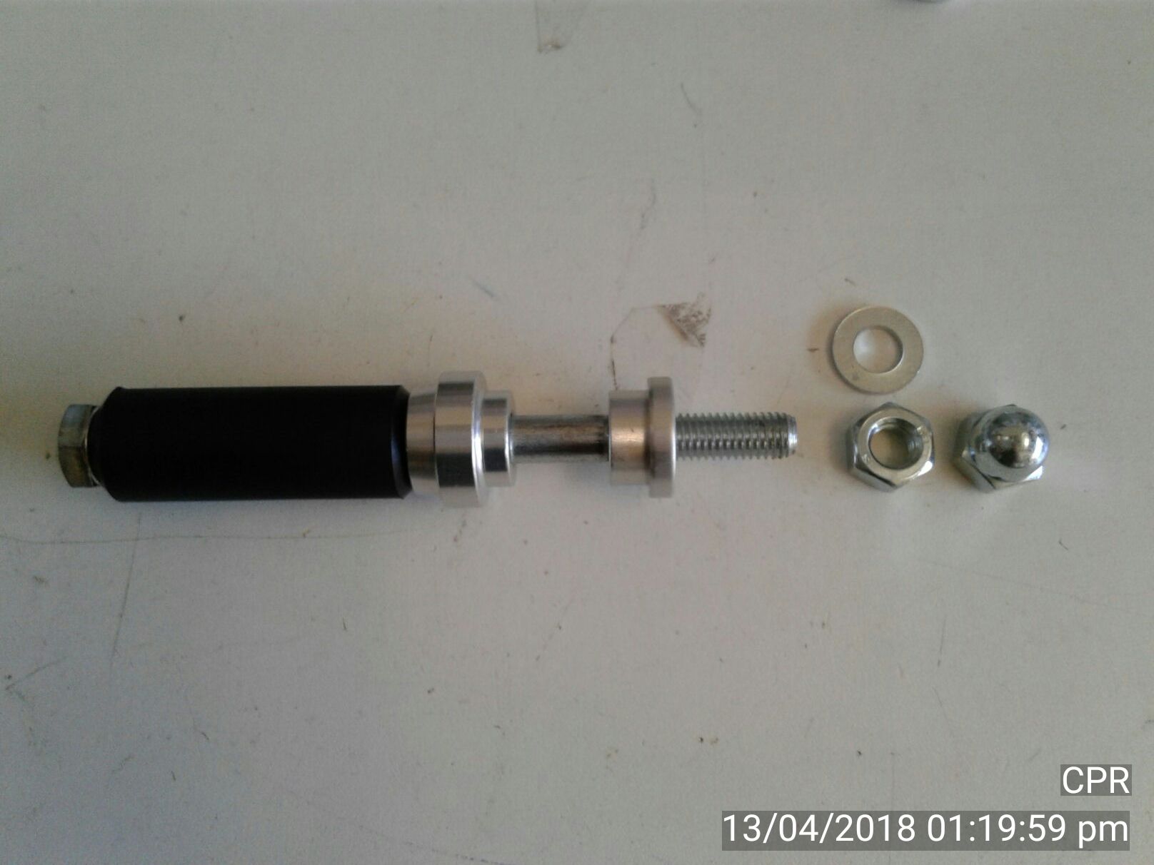

Fit your rear crash bar or if using a plastic bumper fit the bracket.  This part is not shown, then slide the single sided aluminium bush over the bolt so that it keeps the tube from the crash bar or rear bumper mount in place.

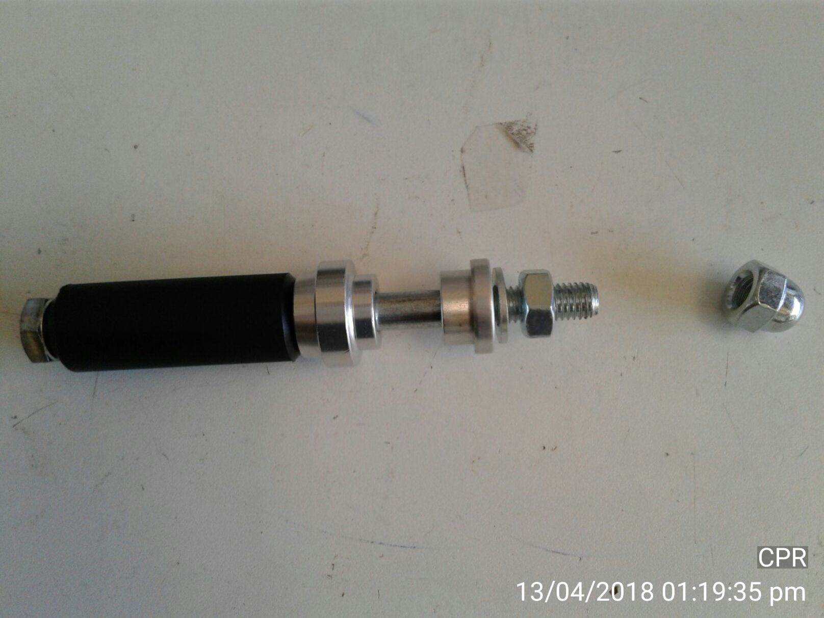

Fit the washer.

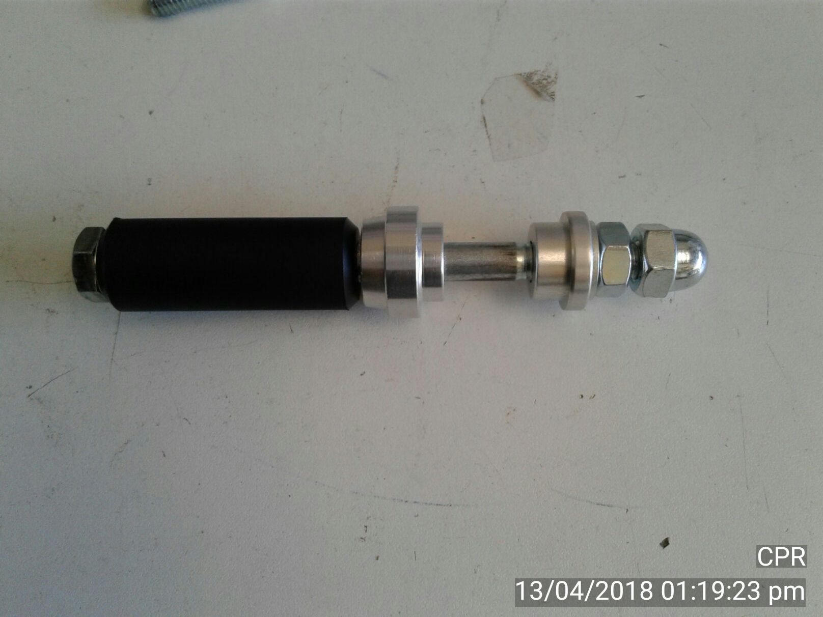

Fit the nut and tighten until the bolt crushes the insert enough that you can no longer remove the bolt from the chassis tube or rail.  The double sided alluminium bush will be pushed hard up against the chassis rail - don't worry, it will not damage your chassis as it is softer than the steel of the chassis rail and will mould to shape.
Fit the dome nut to protect the thread on the end of the bolt from damage.
